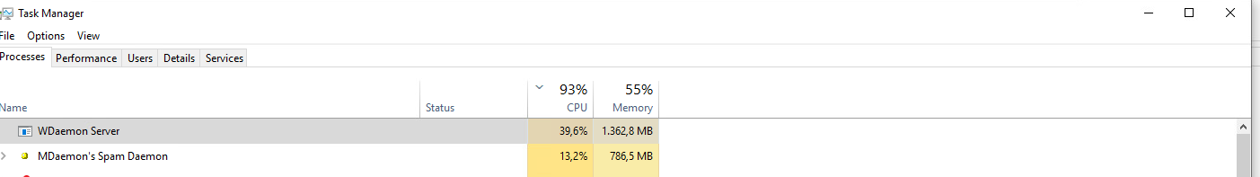

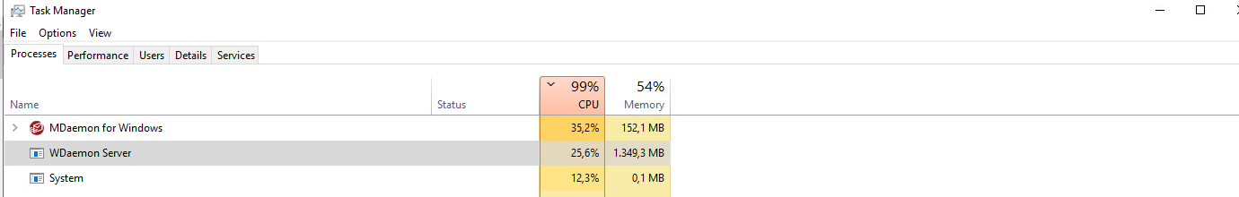

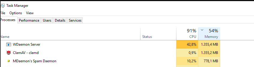

Since the last update we see that the process worldclient.exe usually has >20% CPU usage. It rarely drops below 20 and if it does it only drops for a few moments.
To the worldclient process, if we add other processes (ClamAV, Spam, mdaemon.exe.....) it makes that the CPU has peaks of 99%, which makes that the server goes slow.
Version 25.0.2
Microsoft Server 2019
Ram 16GBTaskManager Screenshots attached.
