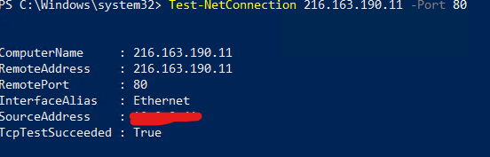

  • Are you still having the issue?
    When you ping files.mdaemon.com, what IP address is returned?
    Is your firewall blocking the traffic on port 80?
    Please post a log snippet that shows the error occurring.
    If outbreak protection is disabled, it shouldn't still be causing a winsock error for new sessions.  If there are still sessions active from before Outbreak Protection was disabled, they will still attempt to query the Outbreak Protection service, but new inbound sessions should not.
