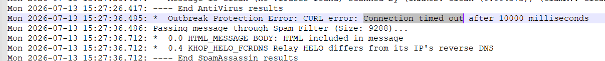

    Anyone have a clue as to why suddenly Outbreak protection would timeout?
    Error in log: Outbreak Protection Error: CURL error: Connection timed out after 10000 milliseconds
    Rebooted Mdaemon server & Service.
    Temporarily disabled Outbreak Protection but still getting the same Connection timed out.

  • Hi @Arron ,
    Please find screenshot attached.
    Seems the Test Connection working. but the ping doesnt.
